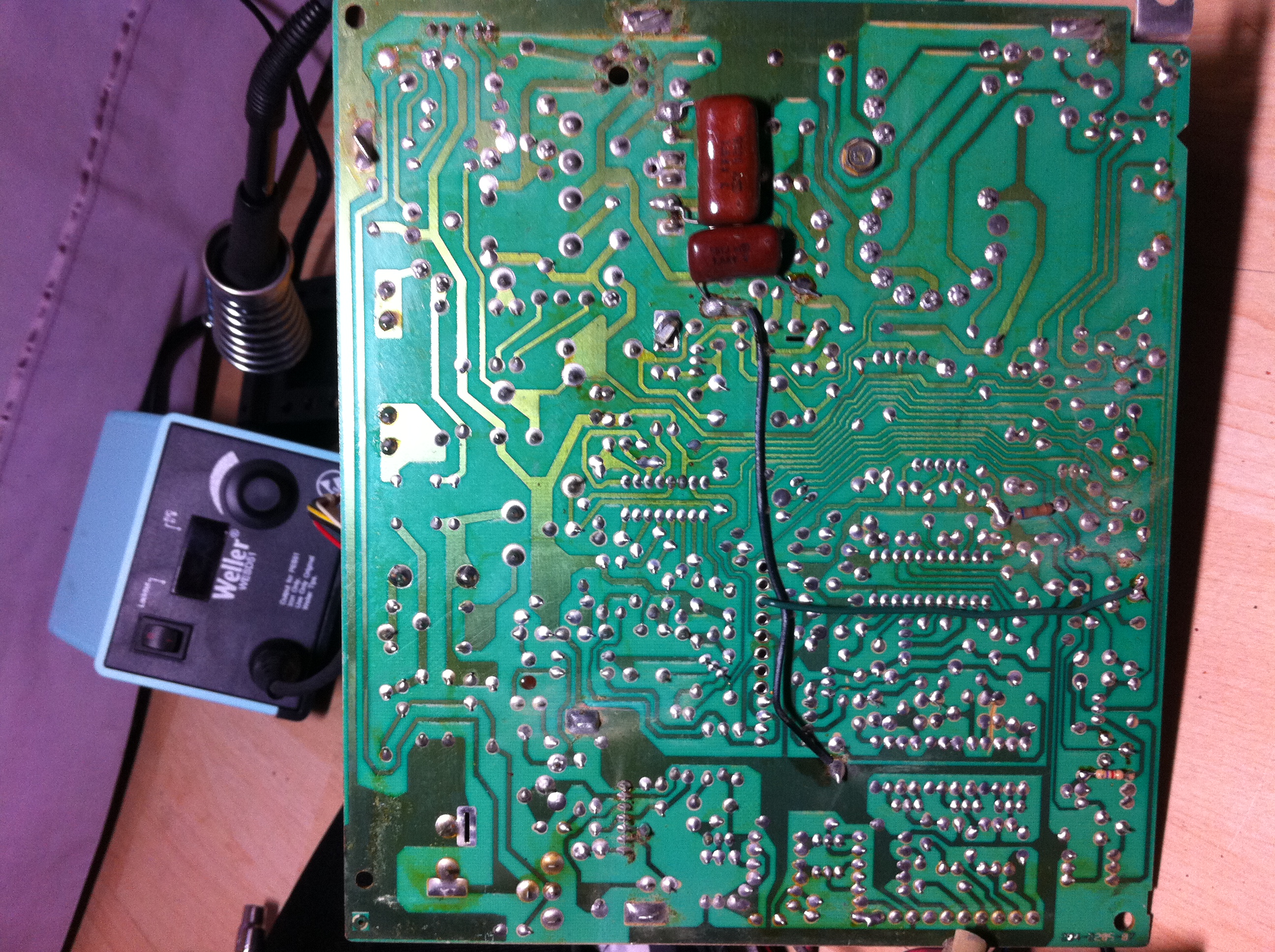

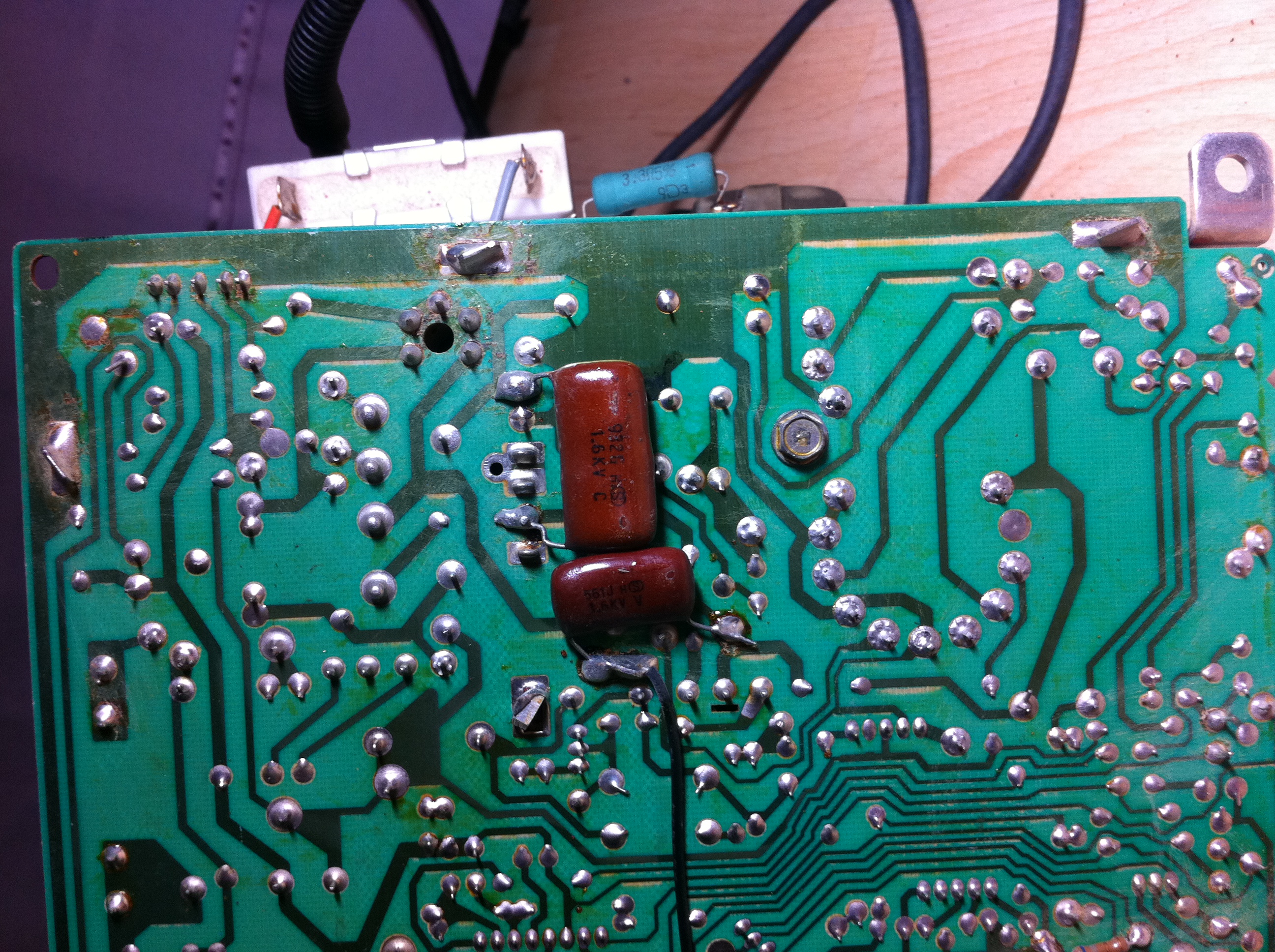

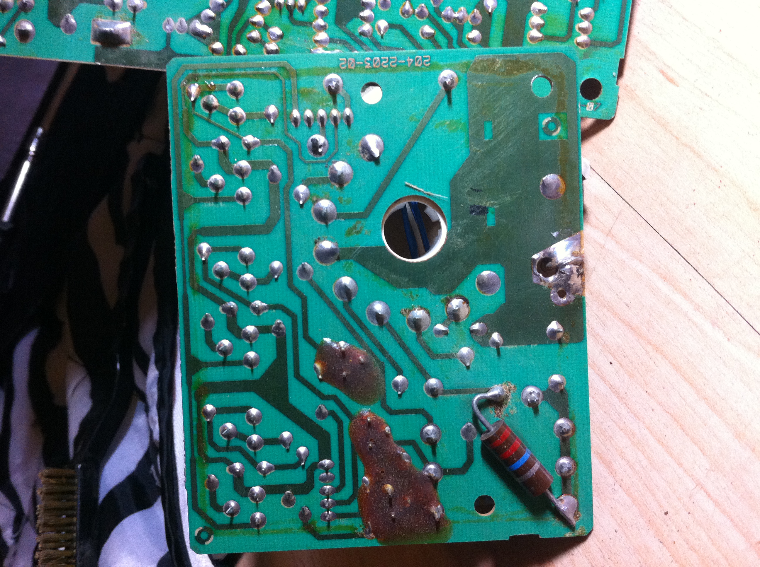

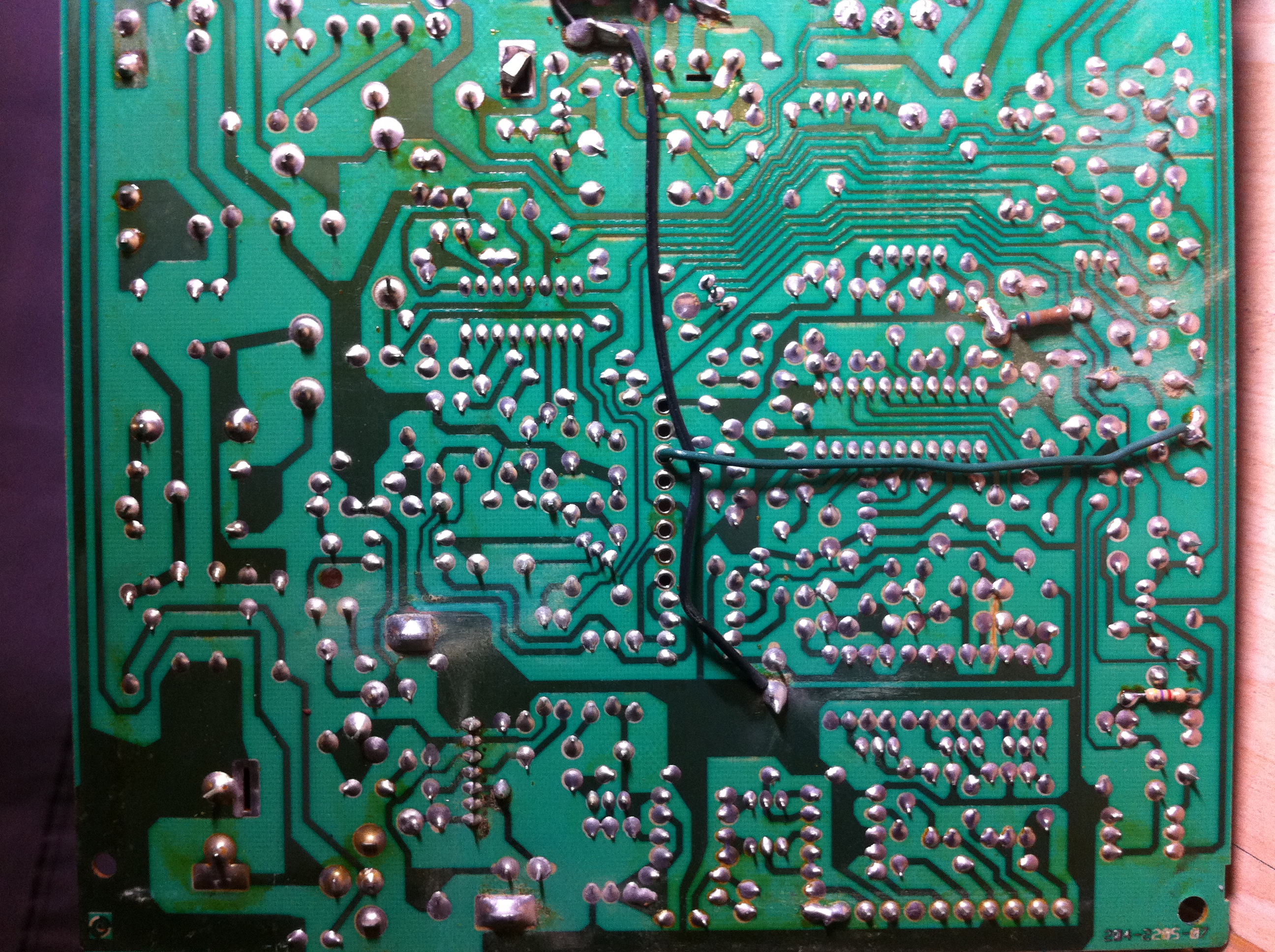

Please find the attached pictures. I have a Wells Gardner 25K7191 chassis that seems to have been modified. It doesn’t power on and I didn’t see any glow in the neck board however, I was outside in the sun and it might have been to dim to see. There are two “chicklets” on the solder side of the chassis board and two jumpered leads. I will get you locations this evening. Do these look ok to you? There is also a resistor on the solder side of the neck board. It all looks a bit suspicious to me. What do you think?

As for your question, these caps actually don’t look too bad. Yes, the locations would be helpful for troubleshooting purposes but the caps themselves look to be in good condition. From your pictures, it looks like the solder is getting pretty old. Michael, whom you’ve probably seen in our posts on monitor repair, always recommends refreshing the solder on any and all points that look cold on your monitor chassis anytime you have an issue such as this. I cannot tell you how many times we have “repaired” a monitor just by touching up solder points without replacing any parts at all. This would definitely be the first step we would recommend to you. A lot of times we recommend a cap kit not because the caps are necessarily bad but because it forces you to touch up the solder on these joints which could be where the issue resides. So, try touching up the solder and see if it makes a difference. Also, be sure to keep us updated on your progress throughout your journey to repair this monitor.
