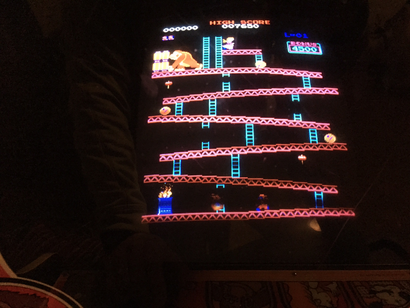

Question from Aaron: I have some dark lines running horizontally through my Donkey Kong monitor. You can see in the picture below where Jumpman and the fireball are not very visible. It gets better towards the top of the screen but is present at all times/all boards on the lower half of the screen. Tried all adjustments on monitor. What might the issue be? How might I address locally? I am not comfortable working on the monitor myself. I live in WI. Appreciate any help.
Response from Jonathan: Aaron,
Looks like your monitor needs a cap kit. Check out our post on Installing A Cap Kit for more information. If you don’t feel comfortable doing this type of repair yourself, check out the Monitor Repair Services & Information section on our resources page for some people we recommend for these types of repairs.
