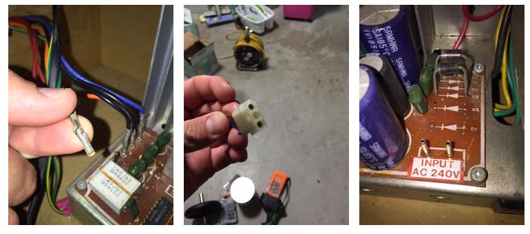

Question from Troy: Hi, I have been trying to find these female connectors for the input on my power regulator. Can I get them or is there something else I can use? I have been looking everywhere. The middle pic is the old connector. Your help would be much appreciated. Thanks, Troy

Based on the connector and the wire, I’m guessing it’s a 0.093 female Molex pin. Of course, it’s hard to know the size for sure but 0.093 is a pretty common size for monitor power connectors. Twisted Quarter sells them for $0.17 a piece plus shipping. Here’s a link to them: http://www.twistedquarter.com/index.php?main_page=product_info&cPath=149&products_id=1054. Again, hard to be 100% sure without seeing it in person but that’s my guess. Hope that helps.
