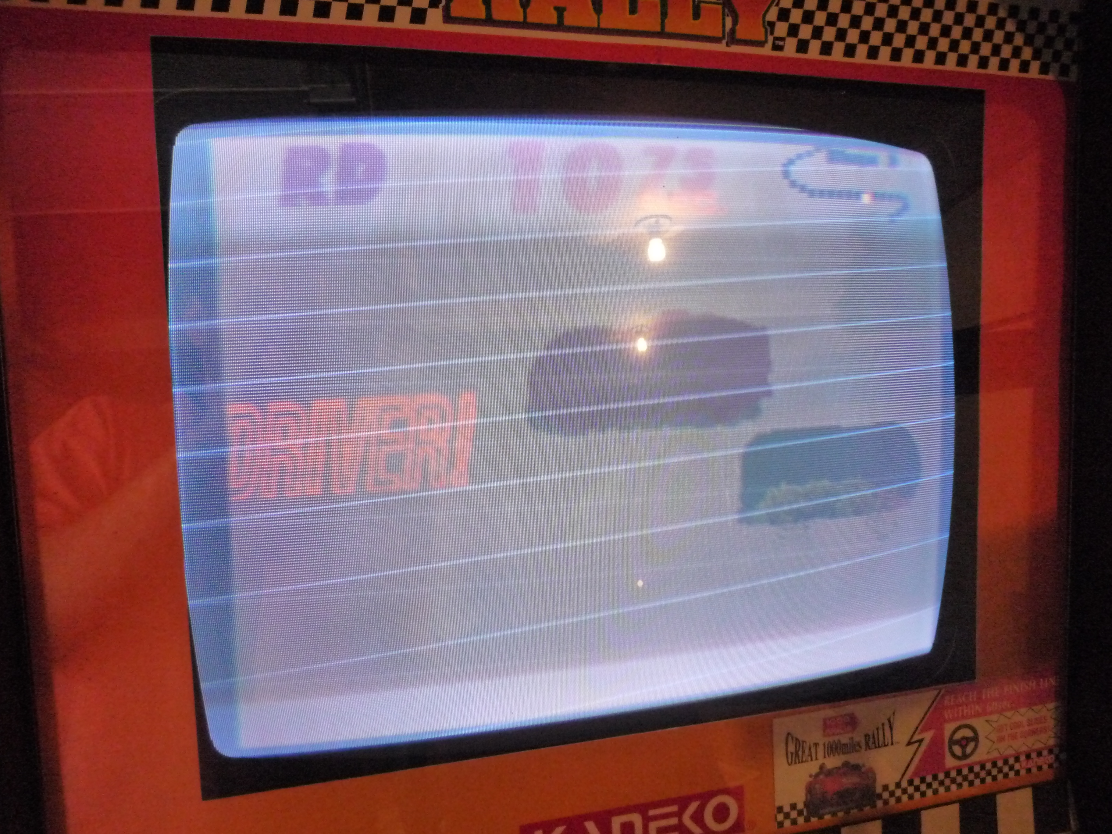

Question from Mike: Hi, I just bought Great 1000 Mile Rally and it is having a graphics issue (see pic). I was just wondering what that issue is called. Can you point me in the right direction into fixing it? I’m not concerned about the lines that are showing yet. I actually found out that the game is Great 1000 Mile Rally 2. Thanks, Mike

Response from Jonathan: Mike,
This looks like it could be related to some bad ROM chips but we would try a couple of things before replacing them. You might start off by making sure our power supply is putting out the correct voltage to the board. Instead of checking your voltage at the power supply, you might try turning off the game, unplugging your board from the cabinet, turning the game back on and testing your voltage at the harness. We believe that Great 1000 Mile Rally 2 is a JAMMA board so you should be able to use these pinouts in order to determine the voltage pins. Make sure you adjust your power supply if your voltage is too high or too low. This should ensure that you are getting the correct voltage to the board.
If you continue to have problems after checking/adjusting the voltage at the harness, you might check out our post on Inspecting An Arcade Board for some helpful tips on troubleshooting board issues. At this point, we would probably try replacing the ROM chips (especially any socketed ones) to see if it makes a difference. You could also try using a logic probe to check the output of some of the chips on the board. There’s a great beginners guide to using a logic probe on Lawnmowerman’s Pac Man Page in case you are unfamiliar with it.
Other than that, you will probably need some additional equipment (such as an oscilloscope) and a lot of time to get the board working properly. At this point, you would probably be better off contacting one of the people under the Board (PCB) Repair & Component Sales heading on our resources page as these people specialize in board repair.
