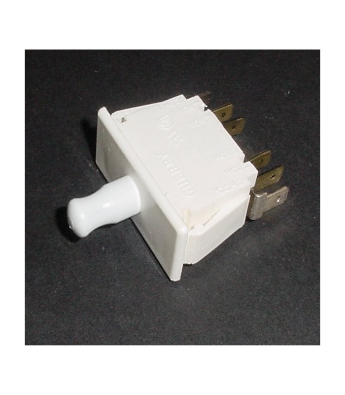

It’s also a good idea to make sure that all of the interlock switches are engaged. An interlock switch is a safety switch of sorts that keeps the game from powering on if it is not pressed in. These are usually located inside the coin door or on the back door (in upright arcade cabinets). Here’s a picture of one so you can get an idea of what they look like: https://www.twistywristarcade.com/1385-large_default/cherry-interlock-switch.jpg. There is a trick to these switches. They usually will only engaged when the switch is depressed but many will also engage if you pull the switch out. Try pulling the switch out to see if it engages properly.
