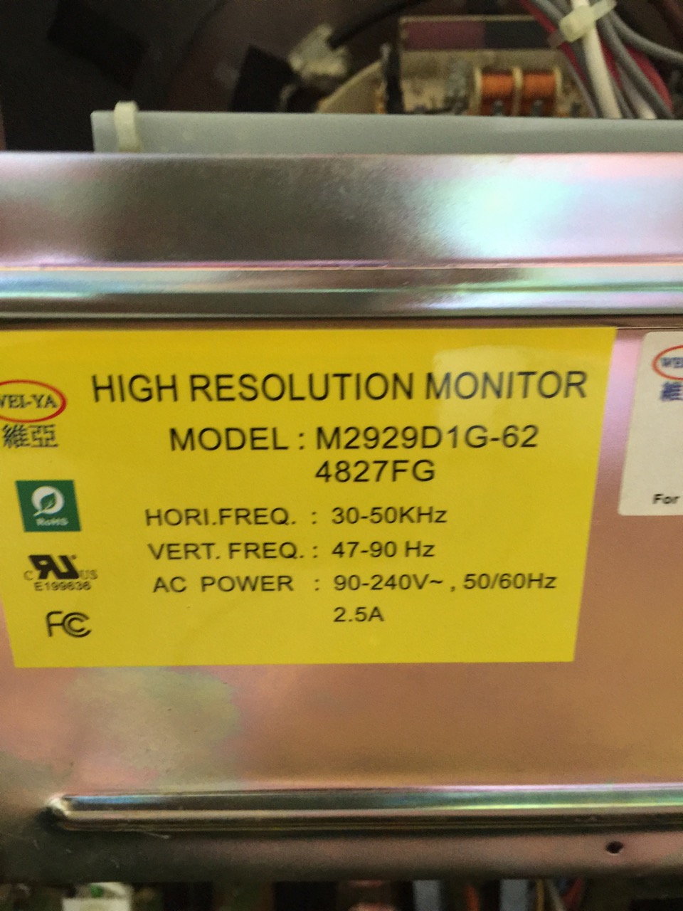

Question from Rich: Hello, I’ve been following your series of YouTube videos on arcade repair. I have a video game arcade cabinet (MAME) from DreamAuthentics (model is the Excalibur). The monitor is non-functional. I’ve reached out to the vendor and they mentioned the monitor is no longer made and there is a very high chance it can be repaired and I should look for a local vendor. They gave me some vendors. I thought I would try you since we are in Texas. The monitor, a Makvision D2929, is non-responsive (blank) with no picture. If I hook up a regular VGA computer monitor I can see the picture so I’ve isolated the issue to the Makvision d2929 monitor. I’ve checked the fuse on the board and it looks fine (although I might replace that). I’ve checked power to the monitor chassis with a multi-meter and that looks fine as well. A light goes on when the board/machine has power so I believe basics like fuse and power are ruled-out as root cause. I don’t see any glow in the neck of the monitor and of course screen is blank/grey so maybe an issue with capacitors or the hot or flyback? What are next steps? Can you give me a quote on how much it would cost to repair (ballpark is fine)? What would be the process? Would I take off board/flyback and mail you just that part? Thank you so much. Rich from Cypress/Houston, TX

Yes, this is definitely related to an issue with something in the power supply section of your monitor chassis. It could be the HOT, flyback or other power supply related parts. Unfortunately we are not familiar enough with these Makvision monitors to know for sure without looking at the chassis with the schematic. Repair costs are probably going to run you anywhere from $150 to $300 depending on the issue.
