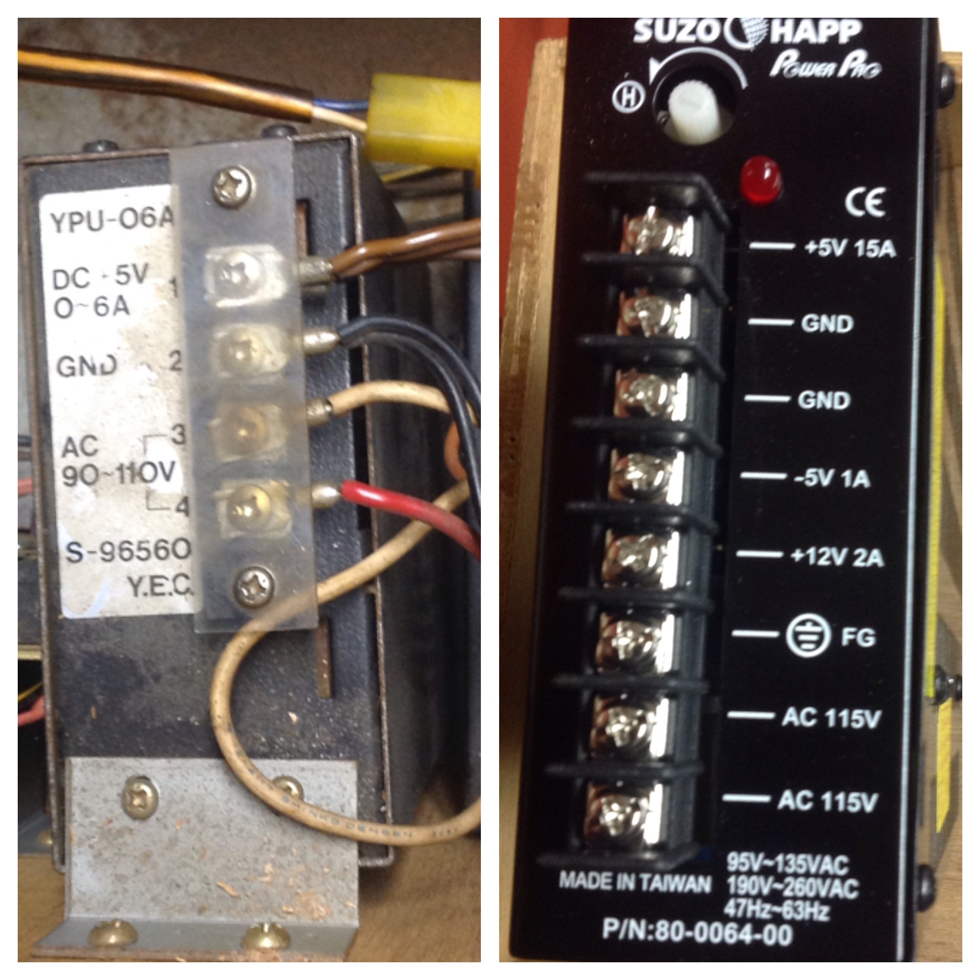

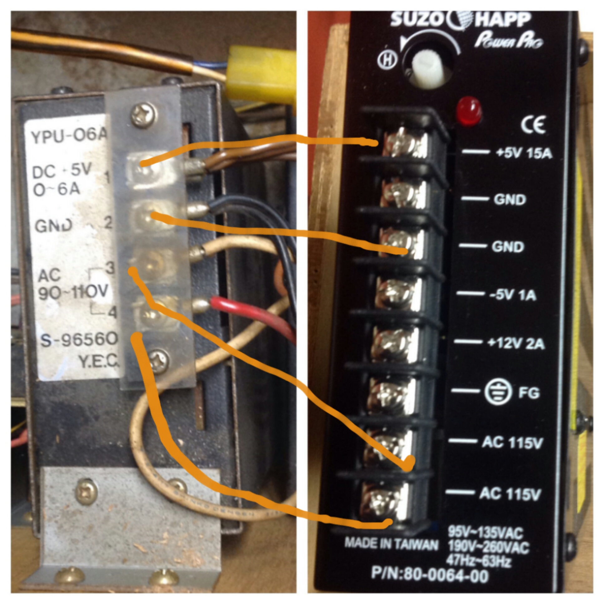

Question from Ed: I was watching your YouTube video about changing a power supply. I “think” I know where the wires go, but knowing I am far more of a pinball guy, I do not feel 100% comfortable doing it until I check in with somebody who is a bit more skilled at it than I. I have included a pic of the old (left) and the new (right). Would you mind having a look and telling me where to move the 4 wires to/from? Ed
