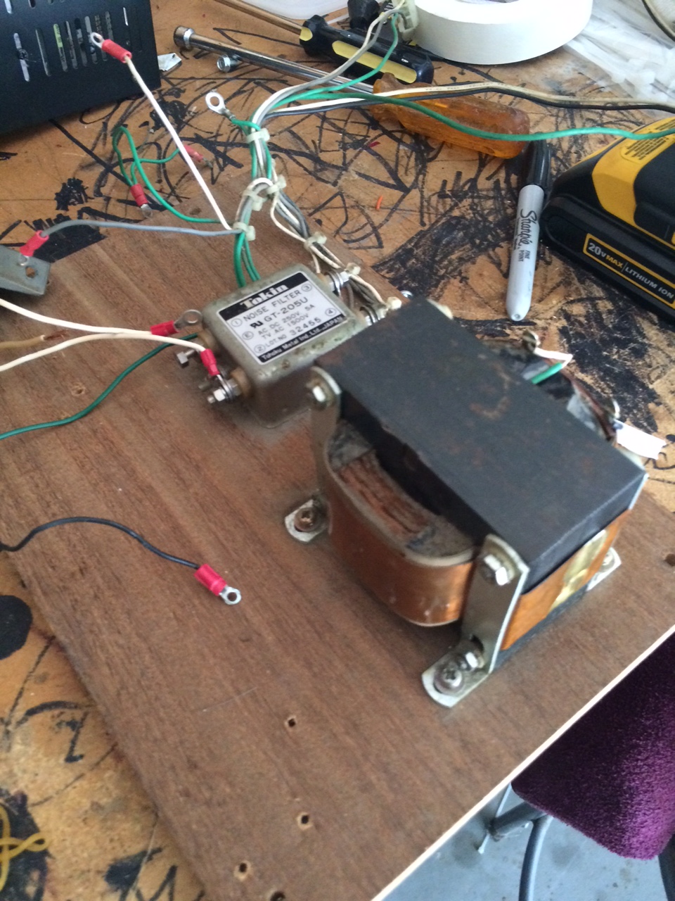

Question from Dennis: I have looked over all your videos and, by the way, they are great and very helpful. I bought a MAME cabinet that had Bestorizer in it and I am changing it out to a 60-in-1 which is simple enough; however, when I disconnected the power supply, I failed to totally check the CRT (I have a Wells Gardner display) on how the transformer which is daisy chained to a noise reducer should be handled to the power supply. Can you help?
Please see the attached picture. I can send more if needed. I was trying to move the on / off switch out of the array so I could access it better.
Thank you, Dennis
Response from Jonathan: Dennis,
Here’s a link to a diagram created by Bob Roberts at therealbobroberts.net that should help you with the AC wiring configuration in your cabinet: http://www.therealbobroberts.net/basic-ac.gif. Please let us know if you have any other questions about the diagram or about AC wiring in general. Hope that helps.
