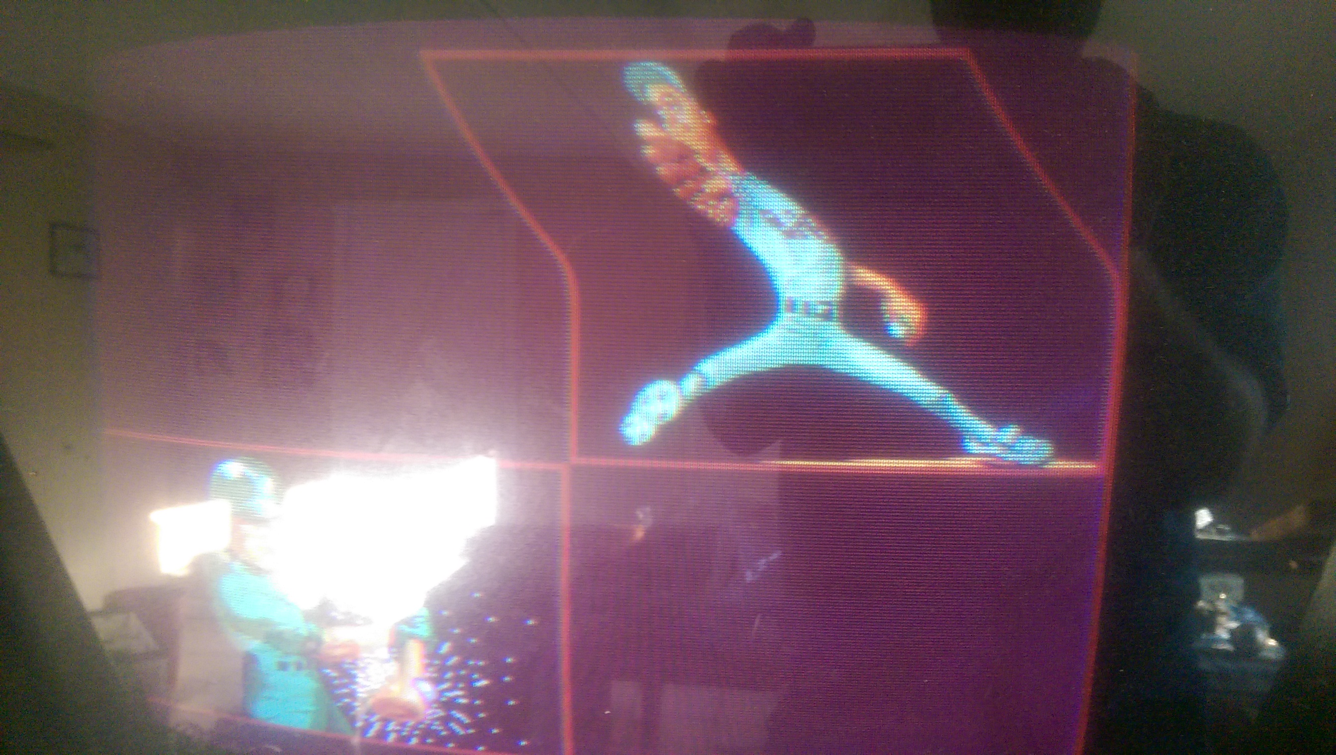

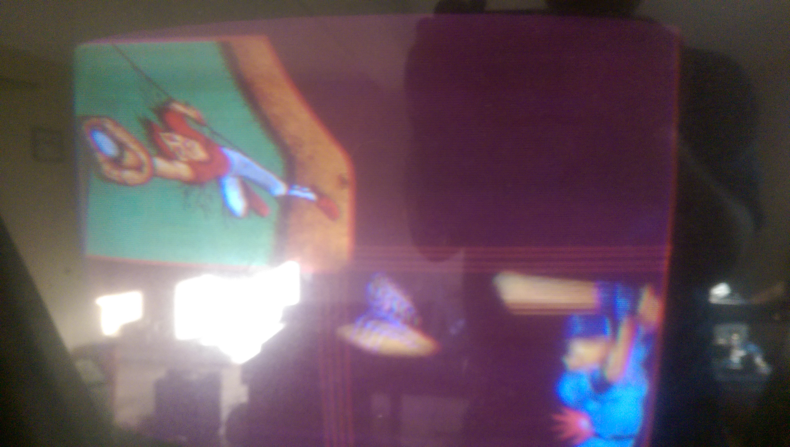

Question: Hi, I am hoping that you can point me in the right direction. I am having a problem with the top of my screen slanting to the left. I’ve attached a couple photos to show what I mean. Any input is appreciated is this just an adjustment or something that needs repaired?
Slanted picture 1 Slanted picture 2

Response from Jonathan: A slanted picture like the one you are experiencing can usually be adjusted out. You might try turning the potentiometers (or pots) for the vertical and horizontal hold/sync to see if it makes a difference in your picture. If it doesn’t, you may need to adjust the B+ voltage pot as well. It could be a problem with some parts on your monitor chassis but considering how good your picture looks I would be reluctant to jump to that conclusion. Hope that helps.
