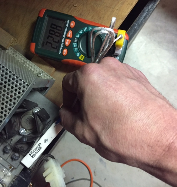

My sound is intermittent, some times I have sounds and other times I don’t. Sometimes certain sounds are missing and if I do have sound it eventually fads out. Again I’m assuming a board issue? There seems to be an excessive amount of heat coming from the board about 228 degrees F when tested with my multimeter (I attached a picture of my test point) so I don’t leave it on for very long! I’m not sure how to check the power supply as I think it is part of the board is this correct? Could the transformer be faulty? And if so how would I check that with my multimeter?

The amount of heat coming from the board is pretty high but should be within the normal operating range. Just to give you an idea, that NTE white resistor that’s in your picture should operate normally from about -60 degrees F all the way to 310 degrees F. Of course, we don’t want the board running at a higher temperature than it should so you might check out some other components in and around the section of the board that you’re testing in the picture to see if they are bad which might be causing your temperature issue. So while the temperature is a bit concerning, it should work fine.
