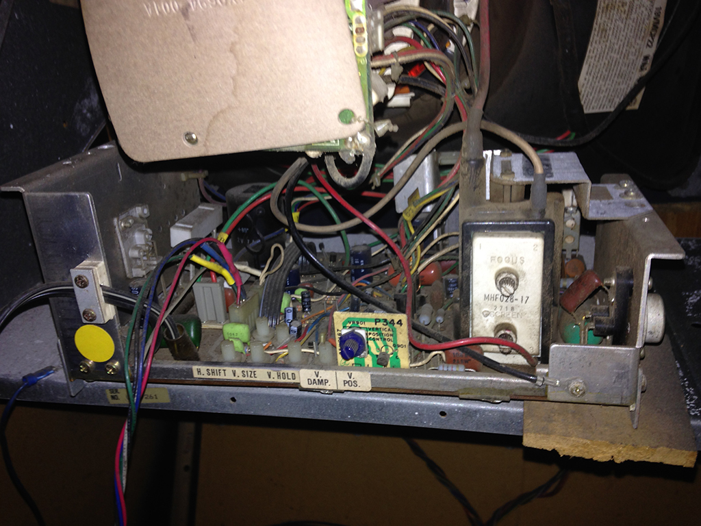

Question from Aaron: Hi Tim, I have a Street Fighter 2 monitor that has a broken Horizontal Width coil adjustment, and it could use new caps. I’m going to swap it out with a different monitor and am interested in sending the chassis to you guys to repair it. This is a standard Wells Gardner chassis (I think). If you know where I can get a cap kit and a width coil, I can just buy those from you too. I’m a really big fan of your videos and I learned a TON from you guys. Thanks! Aaron

Now, you should be able to find a cap kit pretty easily but finding a replacement width coil is going to be tricky. For the cap kit, I would order from Bob Roberts at therealbobroberts.net. Just tell him you need a K4900 cap kit and he should send it right out after you send him payment (he only takes check/money order so keep that in mind). You can ask Bob if he has a replacement width coil as well but I think he ran out of stock some time ago. Your best bet for getting a replacement width coil is probably going to be locating a bad K4900 chassis that still has the width coil in tact. You might look on eBay or ask in some of the different arcade forums to see if anyone has a junk chassis for sale. Of course, you might be able to fix your horizontal width problems with a horizontal width kit as well. Just something to consider.
