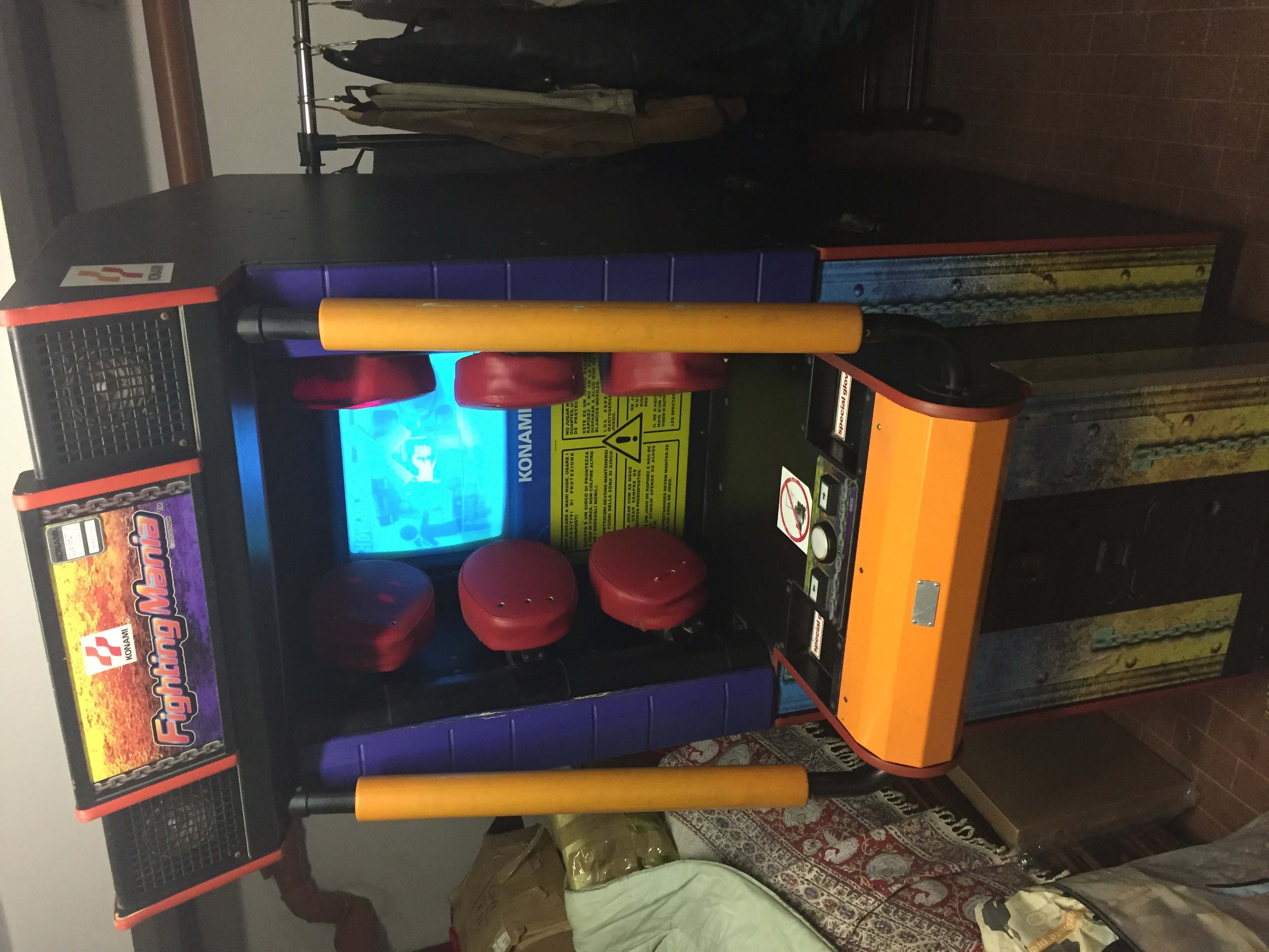

Question from Ray: Hello, I wanted to know if it is possible to put volume controls on a dedicated arcade cabinet. When I turn the game on the volume is way to high and I always have to go into the coin door to adjust volume in the control panel settings. I really want to avoid opening this door or anyone having access to the settings. The game I purchased is Konami’s Fighting Mania. Any tips you may have in helping me solve this issue is much appreciated. Thank you, Ray
