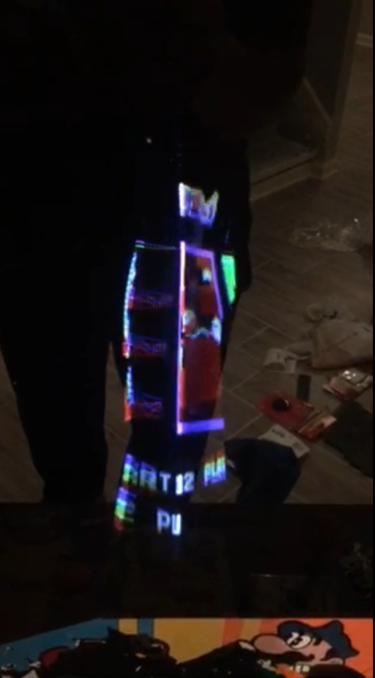

Wells Gardner k7400
Response from Jonathan: Looks like you are experiencing a vertical collapse issue. Probably want to check out the vertical IC chip at location U601 as well as the chip at location U701 on the chassis. Make sure they are getting voltage and working properly. If voltage is not getting to U601, check the value of R619 to make sure it is functioning properly. Not a bad idea to do a cap kit as well while you’ve got the chassis out if you have not installed one recently. Check out our post on Repairing Monitor Collapse Issues for more information. Hope that helps.
