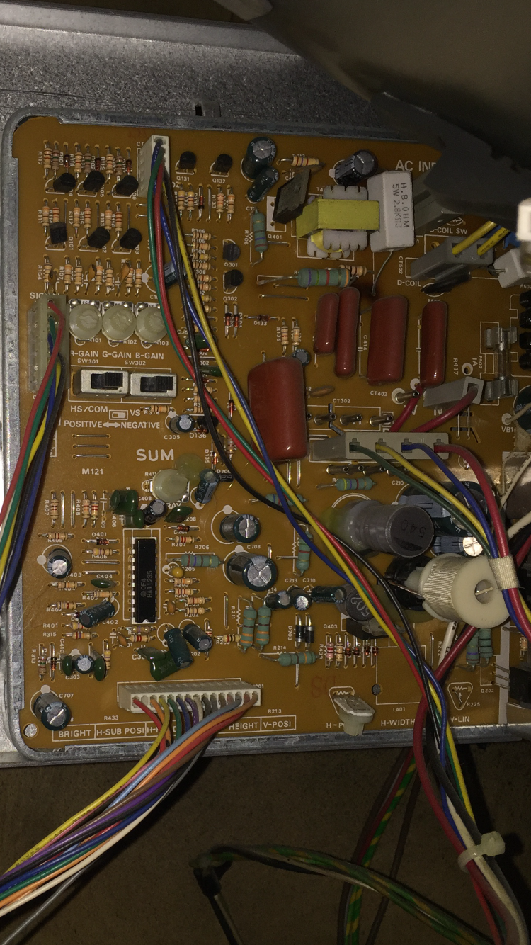

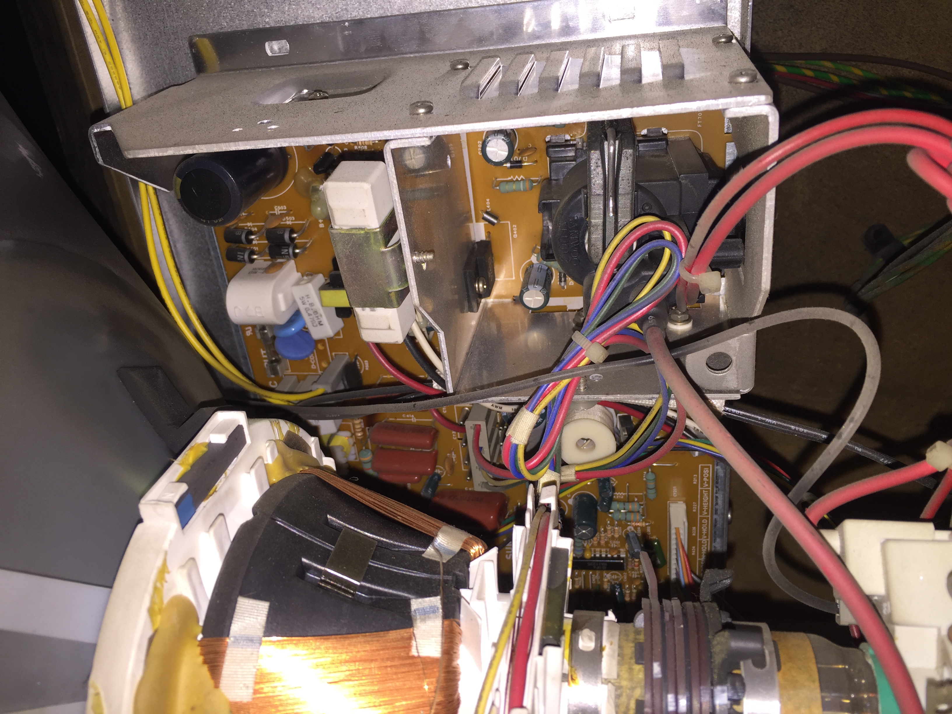

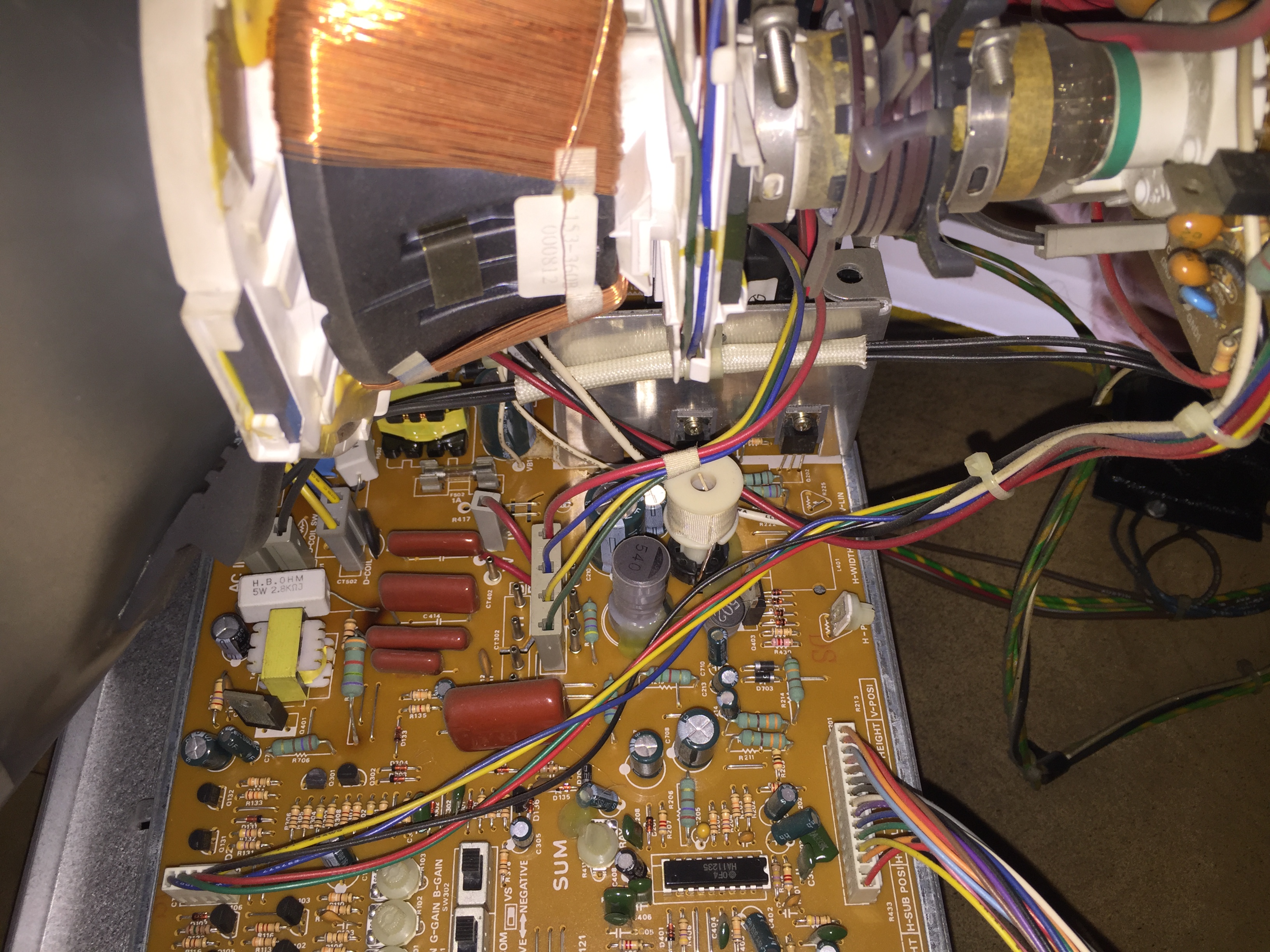

Question from Ed: Although I searched Bob Roberts website with regards to all the pictures he has to reference, I cannot figure out for the life of me what chassis this is. Even though this thing looks brand spanking new, I probably need a cap kit and a video to help me do it. If this chassis is indeed brand-new, I wonder if I can’t adjust some of these knobs or check voltage to see if that might be an issue before installing a cap kit. Ed from Pickens SC

It looks like you have one of the variations of the Kortec KTX-26 chassis. Here’s the link to the picture of this chassis from Bob Roberts: http://www.therealbobroberts.net/mon85.jpg. Arcade Boneyard has some additional pictures of this chassis that look like they are closer to the particular version you have. Here are the links:
Link 1: http://thearcadeboneyard.com/monitors,frames_and_chassis/images/kortek%20-%20kyx26%20-%20si%20327%20monitor%20chassis%20(item%2014).JPG
Link 2: http://thearcadeboneyard.com/monitors,frames_and_chassis/images/kortek%20-%20kyx26%20-%20si%20327%20monitor%20chassis%20(item%2010).JPG
Yes, it’s always a good idea to try to Adjust An Arcade Monitor and check the voltage before going the cap kit route. Hope that helps.
